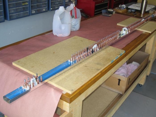

Brief Description:  Preliminary rear spar assembly
Located the holes for attachment of the main ribs (HS-708) to the rear spar and enlarged to #21 (see rear view).

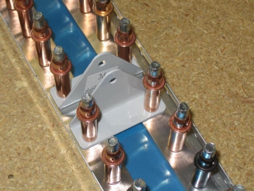

Clecoed the elevator hinge brackets (HS-412PP and HS-413PP) to the rear spar assembly and final drilled to #30.

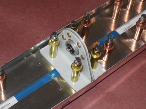

Assembled and match drilled the center hinge bearing assembly to the rear spar assembly (HS-411APP, HS-411BPP and VA-146). Disassembled the center hinge bearing assembly, deburred and riveted together using AN470AD4-5 rivets per instructions.
Clecoed the center hinge bearing assembly (HS-411) back to the spar and final drilled the bolt attachment holes to #12.
Marked all parts in the horiz stab rear spar assembly so they can be returned to their proper position at final assembly step.
Temporary Assembly of Spar
Center Hinge with Bearing
Outboard Hinge
Outboard Hinge
