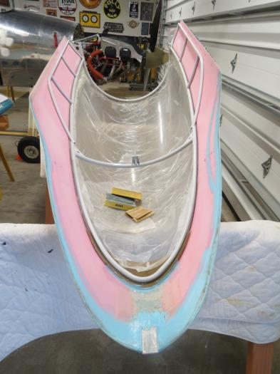

Brief Description:  Working on underside of skirt
On the underside of the skirt I removed the clay material, applied filler, and then sanded. This was a multi-step process until I got the finished look I wanted. Particular attention was required around the canopy rail slot.
I also cut a couple canopy stops from rubber fuel line and inserted in the canopy side rails to keep the canopy from banging back against ther rear seat bulkhead.
Removal of Clay Material
Adding Filler
Adding Filler
Canopy Stops
Canopy Stops
