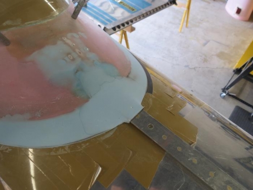

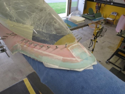

After sanding and adding additional filler followed by more sanding the skirt was ready for a littl glass cloth. Cloth was added with some peel-ply to make the surface a little smoother. Still trying to get just the right contour before finishing the skirt with additional layers of glass cloth.

Sanding the Rail Slot
Applying Cloth & Peel-Ply
