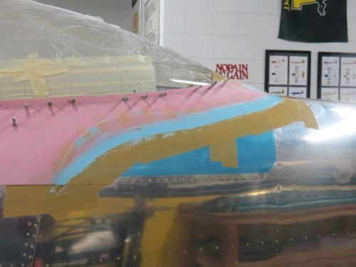

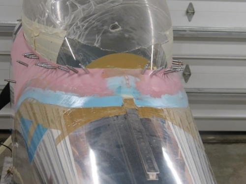

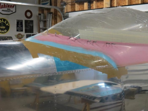

Brief Description:  Begin fitting canopy skirt - Part 3
Today's task was to butter the edges with Poly-Fill to be sanded down to the desired contour. Once it looks good and the fit appears decent I will apply mulltiple layers of glass cloth creating a newly contoured skirt that hopefully fits.
Starboard Side with Filler
Filler on Port Side
Filler on Port Side
Aft View
Aft View
