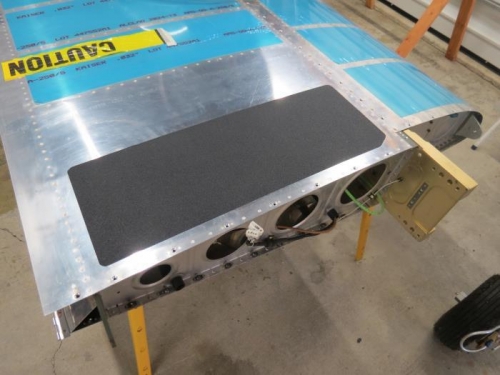

Using wing walk material from Ray Allen I attached it to the port wing (after all, you mount a horse from the left side) after cutting to appropriate size and shape. The material has a pressure sensitive adhesive on the back that seems to hold fairly well.

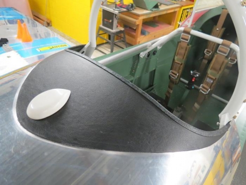

After trimming the leather glare shield I installed the edge protector which creates a blunt edge on the fuselage skin and creates a nice finished edge to the shield. The edge also adds a small degree of safety in the event of an accident.
The white Garmin antenna is going to get a light coat of flat black paint.
Port Wing Walk
Port Wing Walk
Glare Shield Completed
