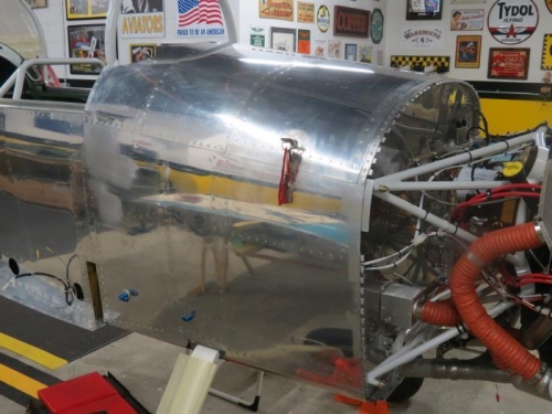

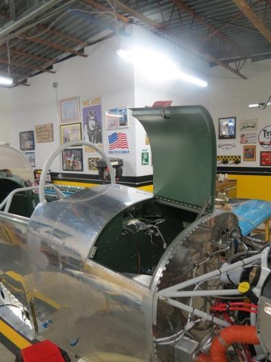

I used a combination of solid flush rivets and a few Cherry Max rivets to complete this task. I wasn't sure I could get really well set -4 rivets in certain locations so I opted for Cherry Max alternatives. I think the results look good and I am confident of the structural integrity of the fastened skins and longeron. Also, the baggage door fits nice and the firewall/skin bordering the baggage door has stiffened up a bit.
Starboard View
Starboard View
Baggage Door Opened
Baggage Door Opened
