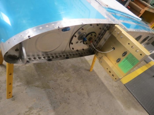

Brief Description:  Replaced std platenuts with movable ones
The two wing attach platenuts per blueprints are std fixed nuts. I replaced them with the movable type allowing the bolts to more readily engage the threads. This required drilling out and replacing the two nuts on each wing spar, easy rework.
Two Wing Attach Platenuts
