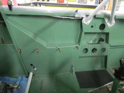

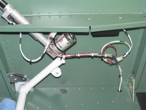

Brief Description:  Flap acuator wiring and enclosure
Installed the flap actuator and determined final route for wiring harness. Also, test fit the interior panel to enclose the actuator so it doesn't interfere with the rear passenger's left arm. This fabricated cover is more for aesthetics than any operational or safety issue. Later, I had to rework the actuator upper cover a bit after discovering it interfered with the seat hinging forward.
Actuator Wiring
Actuator Wiring
Actuator Enclosure
Actuator Enclosure
