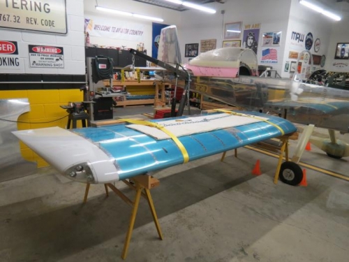

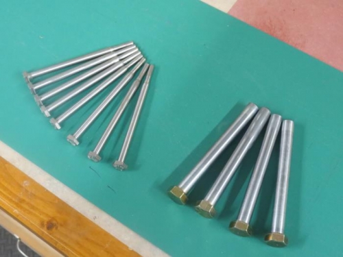

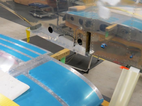

Spent the afternoon finishing up a harness I plan to use to attached the wings to the RV-8. Frankly, this is an experiment to see if Connie and I can do this task without scheduling some friends to provide muscle power. I think we will be able to lift the wing a couple inches and slide the spar stub into the fuselage box. Once it is close I should be able to insert some drift pins I fabricated to temporarily hold the main spar while I set the wing incidence and drill the rear spar. Anyway, that's the current plan.
Drift Pins (Grade 8)
Wing Sling
Wing Sling
Spar Stub & Box
Spar Stub & Box
