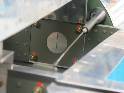

Good bit of progress on the aeroplane today. I believe the entire tail section is compete and assembled for the final time. I began the day by changing the washer/spacers that connect the elevator push/pull tube. Instead of three std washers on each side of the rod end bearing I used two large diameter washers next to the bearing and then two std washers outboard on each side. That is more in keeping with the std method of guarding against a bearing failure.

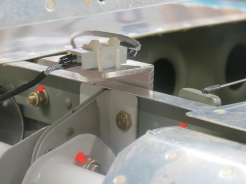

Next step was to double-check the trim wiring and install the molex connectors. The trim servo was installed and tested one final time. The control arm on the servo required a slight bend to ensure it doesn't chafe against the access plate when approaching full down pitch.

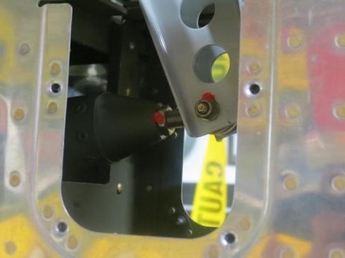

The vertical stabilizer was installed and all bolts and nuts torqued. The wiring for the nav and strobe light was routed and the molex connector installed. A snap bushing was used where the wiring passes thru the main spar on the vertical stab, again to protect against chafing. Torque seal (orange) was applied to all the fasteners.
