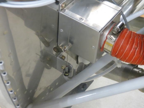

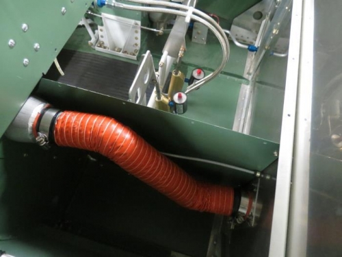

Brief Description:  Throttle quadrant installations - Part 2
This is a continuation of the previous log entry. I installed the starboard interior panel which forms a portion of the forward baggage compartment. The control cable and the scat tube for the heater box is routed thru this area. This is not the stock arrangement but there was more real estate on this side of the firewall than on the port side. I know from looking at another bird that there is still room above the box for an inverted oil system later.
Cabin Heat Scat Tube
Heater Box & Cable
