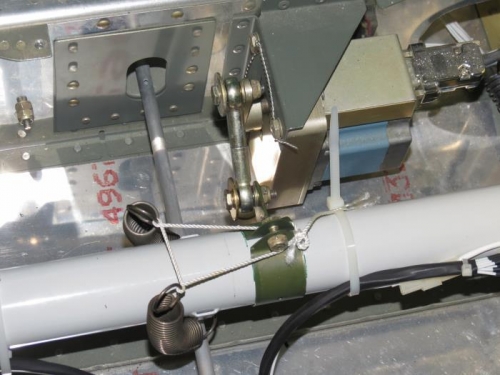

Number of Hours:  1.00
Brief Description:  Autopilot linkage
While checking the torque tube for full movement and any effects on the wiring harness I also temporarily installed the autopilot servo linkage to get its final position. It was marked so when the tube is next removed I will drill and rivet the bracket to the torque tube.
Autopilot Servo & Tube
