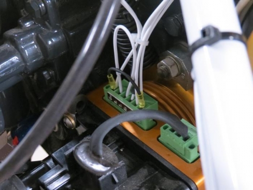

Pmag diode circuit for tachometer voltage
The wires on the starboard mag include a jumber to select the "A" performance timing curve and another jumper to reduce the tach pulse voltage.
Mag Jumpers
