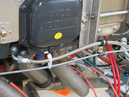

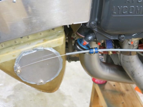

Brief Description:  Alternate air inlet control cable
Installation of the control cable for alternate air on the snorkel. Note the cable safety tied at the Adel clamps to ensure they don't slip. The intake door can be opened by pulling on the cable in the cockpit, however, it must be closed at the door.
