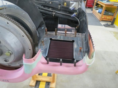

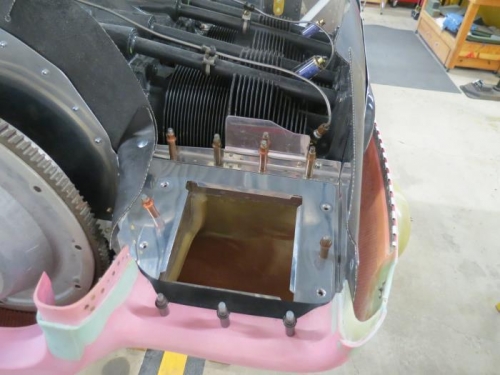

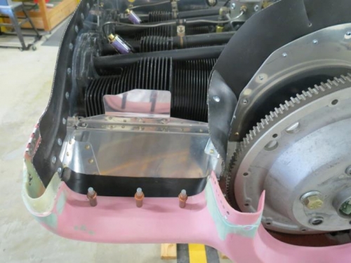

Brief Description:  Rubber seals air intakes
Fabrication of the rubber material that will seal the lower cowl against the intake ramps. The Port side cowl and ramp fits so tight that the filter retaining plate is installed after the cowl with its seal is installed. The retaining plate is then slid under the rubber seal and scewed around its circumference.
Starboard Intake Seal
Port Seal at Filter
Port Seal at Filter
Filter Installed
