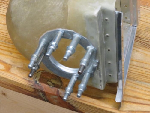

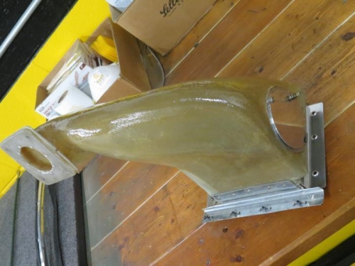

The air door hole was cut to proper diameter and the mounting ring was bonded into place and then riveted. A later posting will show the door and actuating cable installed. I have also included a picture of the finished snorkel. I put a thin coat of resin on the entire assembly to further seal it and add a little surface protection.
