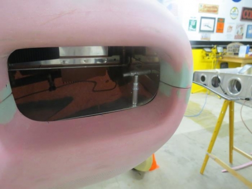

Brief Description:  Inlet ramps with gussets and cowl
Again, if using a Lycoming IO-360-M1B configured engine with snorkel (air intake) don't bother with the port side gusset. There is no room for the gusset once the snorkel is fitted and the filter installed.
Starboard Intake
Starboard Intake
