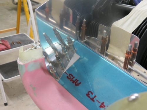

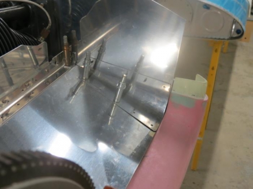

Brief Description:  Inlet ramps and conical gussets
Forming these gussets was a challenge. I started with a cardboard pattern and then bent the conical shape about a 1/8-1/4" at a time in a bench vise. It was a slow and very repetitive process but at can be done. Unfortunately, I found out later that the port side gusset had to be discarded to get room for the intake air filter and snorkel.
Port Ramp with Gussets
Starboard Ramp Gusset
