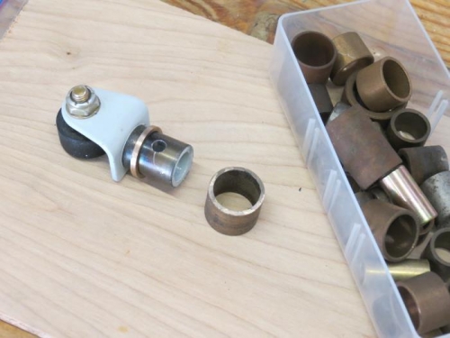

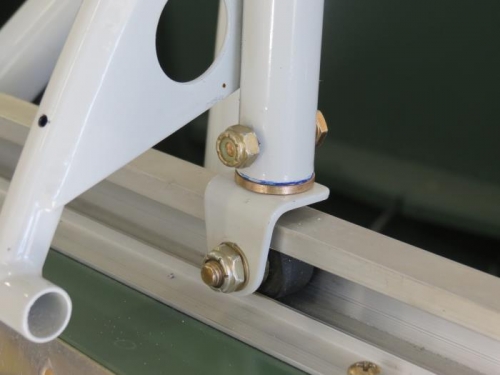

Before fitting the canopy skirt there are some tasks to complete. First, I needed to fabricate a 1/16" spacer to raise the canopy frame just a bit on the starboard side. I lucked out finding a copper bushing that was just the correct ID size to fit over the shank on the roller. Next problem was to cut a slice from the bushing exactly 1/16" thick. That was accomplished with a hacksaw, Dremel cutting wheel, a file, some sandpaper, and careful use of a 1" belt sander. You can see the result in the photos. After installing t he spacer I had to match drill the roller component to the canopy frame for the bolt and nut (see below).

Fabricated Spacer
Fabricated Spacer
Installed & Drilled
Installed & Drilled
