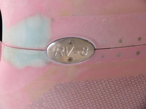

I spent some time this morning with a Dremel and sandpaper cleaning up t he fit of the cowl pin covers. The fiberglass needed some material removed to recess the covers a bit. Also, the covers had to be countersunk to get the stainless screws flush.

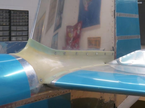

I also accomplished the final fitting of the empennage fairing. This consisted of countersinking all the attachment holes for #6 screws and countersunk washers. I decided to use the washers to spread the stress on the fiberglass around the screw holes. After countersinking, the fiberglass is pretty thin around the holes.

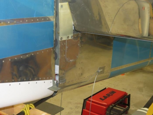

Port Pin Cover
Port Pin Cover
Fairing Screws & Washers
All Buttoned Up
All Buttoned Up
