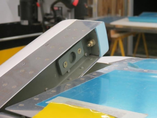

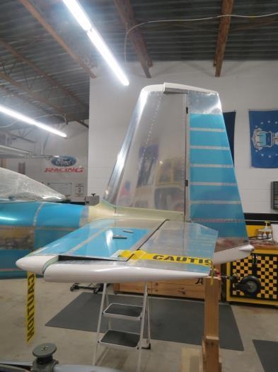

After adding some SuperFil to cover the lead counterweights I had to remove just a little material from the steel counterweight previsouly installed in the elevatro tip. I had to experiment a bit to get the weight right. Anyway, the elevator now balances neutral to slightly up.
Modified Weight
Modified Weight
In Trail Slight Pitch Up
