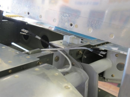

Brief Description:  Rudder wiring
I really wrestled with the rudder wire routing and connector choice. In the end I decided to bring the wire out of the fuselage at the lower hinge just to the right side of the hinge bracket. The hole in the spar was is fitted with a snap bushing and the wire lead is long enough to stow in the rudder cap after connectioin. The other end of the wiring connects to the fuselage lead with a Molex connector under the empennage fairing.
Molex on Rudder Wiring
Wire Exit for Rudder
Wiring for Trim & Rudder
