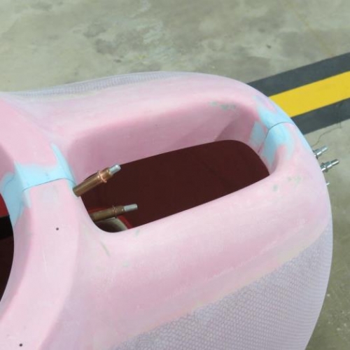

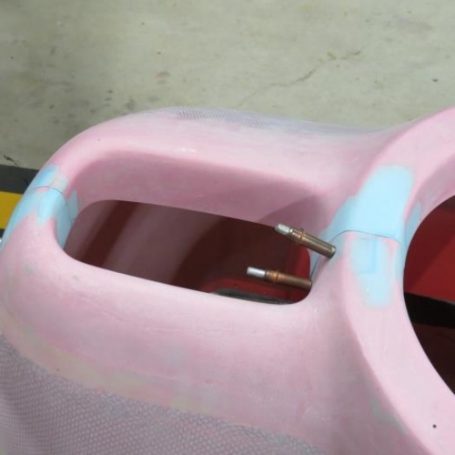

The cowl halves were fastened together and all the mislatched edges were sanded and buttered with SuperFil. After curing the edges were sanded smooth and once again touched up with filler. After another sanding the cowl halves fit together nicely.
