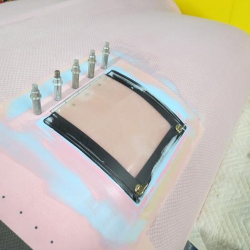

The opening molded into the upper cowl for the oil door was very rough. After cutting and fabricating the door and hinge I decided to do some fiberglass work to make the door fit better. I covered the door edges with electrical tape, buttered the recess around the door opening, and closed the door.

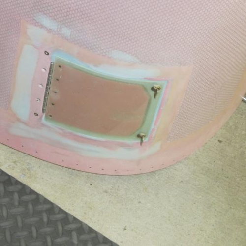

After the SuperFil cured I removed the door and did some sanding to clean up the filler. The fit and finish of the door is much better though more work will be required before paint.
Fitting and Filling
Fitting and Filling
Cleaned Up
Cleaned Up
