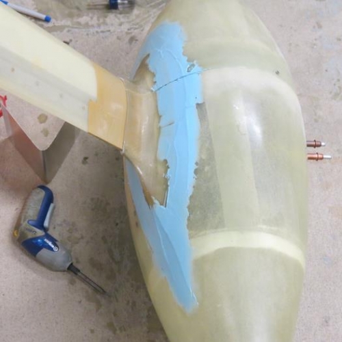

Brief Description:  Lower gear leg intersection fairings - Part 3
Today I am working on the starboard wheel pant. Again, I am using SuperFil to fair the two pieces of fiberglass together. I also did fiberglass layups where the fairing meets the gear leg (see previous posting for description).
Something I forgot to mention is that I was able to tweak the fit of the fairings to the gear leg by heating the fiberglass with a heat gun and reshaping it slightly for a better fit. This was a technique described in the instructions that came from Fairings Etc.
Starboard Pant
Starboard Pant
