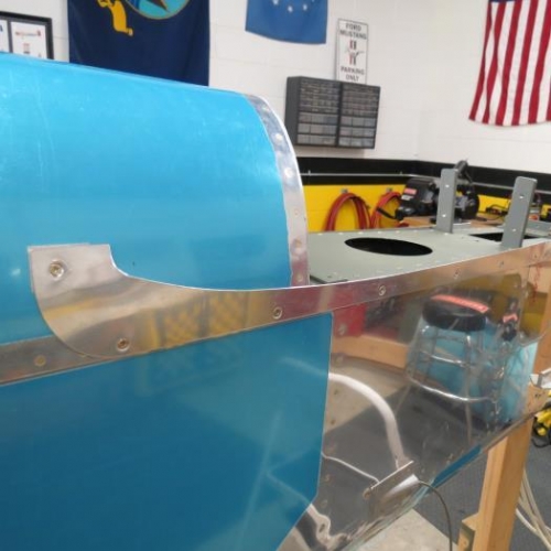

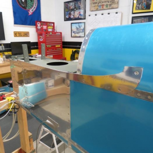

Brief Description:  Initial installation of metal empennage fairings
I completed the initial steps in installing the metal fairings that go under the horizontal stabilizer. This required final drilling, tapping, and countersinking of the appropriate holes along the upper longeron and skin. The fairings were dimpled for #6 screws and attached. The fairings have not yet been trimmed for installation of the rubber weatherstripping.
Starboard Side
Starboard Side
Port Side
Port Side

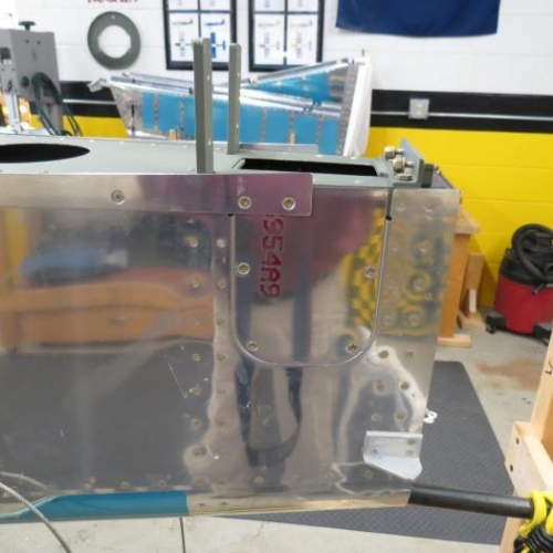

Inspection Plate Overlap
