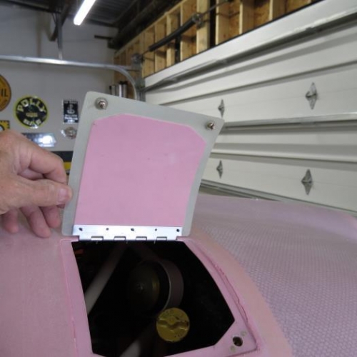

Brief Description:  Completed oil door
One custom mod on the door was to save the cutout from the cowl and glass it to the inside of the oil door. This stiffens the door so it should not "bulge" when pressures build up inside the cowl during flight.
I also used a spacer to lower the hinge profile to make the installation look a little smoother on the outside.
