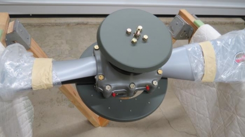

Today was a long day fabricating the spinner bulkhead and backing plate with doubler. The 13" backing plate had to be cut to match the doubler. This was primarily a fly cutter operation (very carefully accomplished on a drill press).
Once the main plate was cut it was match drilled, deburred, prepared and primed. Finally, the backing plate was riveted to the doubler.
Plates Ready
Plates Ready

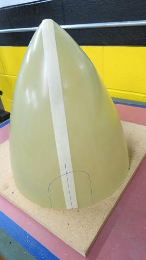

Trimming Spinner
Trimming Spinner

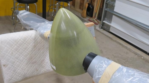

Fitting Spinner
Fitting Spinner
