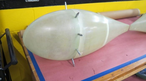

Brief Description:  Began wheel pant prep and installation

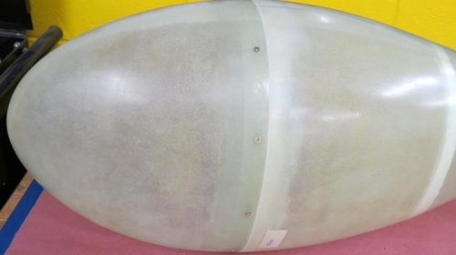

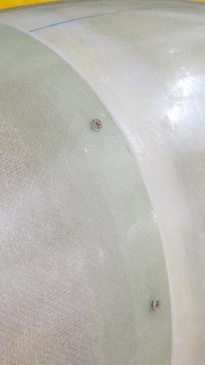

Today was devoted to trimming and fitting the two piece wheel pant assemblies. The fiberglass moldings are good but they still require quite a bit of trimming and sanding to get a neat fit between the halves. Once the fit is good it's time to match drill and install the seven nutplates in each fairing. I then countersunk the nose pieces and secured with the flush head screws called out in the plans. I may revisit the counter sinking at a later date when the pants are prepped for painting.
The assemblies should be ready to install on the main gear.
Two Pieces Fitted
Two Pieces Fitted
Screws and Nutplates
Close Up
Close Up
