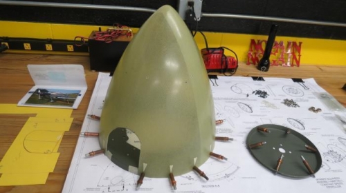

Today I checked and rechecked the spinner to be sure it is centered. Also checked the propeller pitch changes stop-to-stop to be sure there will be no interference as theprop is exercised full range.
Next I match drilled the fiberglass spinner to the two plates. All the nutplates were then installed and the spinner was placed back on the prop in preparation for fabricating the fillets.
Match Drilling Spinner

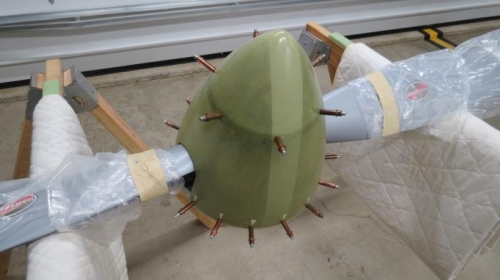

Drilled & Clecoed
Drilled & Clecoed

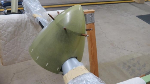

Clecoed on the Propeller
