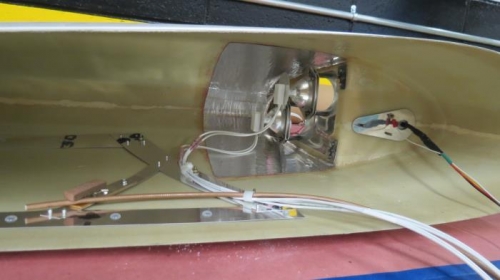

Next task was to install the Archer antenna in the port wing tip. The leading edge of the antenna is fastened to the tip with three screws. The rest of the antenna is bonded with epoxy to the tip. I drilled a #30 hole about every three inches in the flat aluminum antenna, scuffed the area around the holes with scotchbrite, and epoxied the strips to the tip. I made sure the epoxy squeezed up thru the holes to ensure a good bond.
Next, I spliced some 14 awg wire to the landing and taxi lights and routed the bundled wires thru the plastic guides supplied with the Archer antenna. I also cut a length of coax which will attach to the antenna on one end and the coax cable that runs thru the wing to the ILS/GLS radio in the panel. Still have to terminate the coax.
Finally, I added a ground wire to the AeroLed lights and bundled it with the power wires. Still need to attach the molex pins and connector.

Wing Tip Wiring
Wing Tip Wiring
