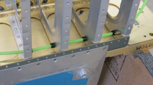

Brief Description:  Nav/strobe light wiring & SafeAir pitot line

Pitot Bulkhead Fitting
Aluminum to Nylon Union
At Wing Root
At Wing Root
