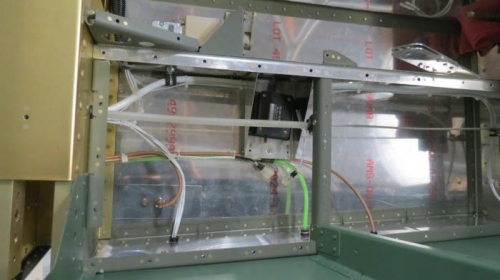

Date:  8-31-2014
Number of Hours:  1.00
Brief Description:  Rerouted Archer antenna coax and terminated

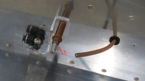

While installing the flexible pitot tubing I rerouted the coax cable for the Archer antenna to exit the fuslage a bit farther back. This allows the coax to be connected to a female BNC connector (bulkhead type) facing forward. The coax coming from the wing root will have a matching male connection. I had to fabricate a small L shaped bracket to secure the bulkhead BNC connector. You can see it in the photo below help by a cleco.
I still need to attach the BNC connector to the coax and mount it on the bracket. I plan to order a couple bulkhead BNC connectors from Allied Electronics.
Archer Coax
Archer Coax
Bulkhead BNC Bracket
