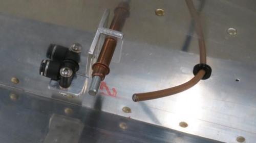

Date:  8-31-2014
Number of Hours:  4.00
Brief Description:  Installed pitot tube in fuselage and terminated
Most of the day was spent running the pitot tubing from behind the instrument panel down thru the port gear tower and thru the center section to a bulkhead quick connect fitting. I fabricated a small L shaped bracket to secure the QD fitting. The flexible pitot tubing that comes out of the wing root will be cut to fit the QD fitting once the wing is installed to the fuselage.
