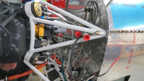

I picked up a fitting from a local auto parts store for attaching the crankcase breather tube to the engine. The breather tube was fitted to the aft side of the engine including the double adel clamps that attach it to the engine mount. The end of the breather is just above the exhaust pipe. I am not sure yet whether this is the correct position but I suspect it is at least close.

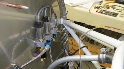

I installed the oil fittings in the engine and temporarily attached the oil lines and check for fit. They seem ok but I haven't got the oil cooler mounted for a final check.
Sensor Manifold
Sensor Manifold
Various Lines & Breather
