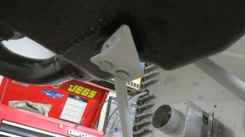

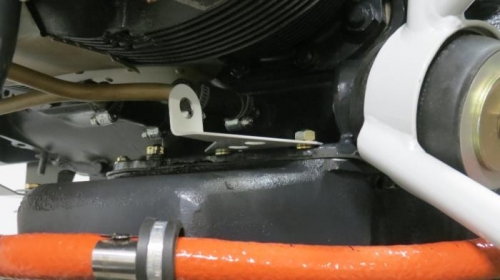

While checking the fit of fuel system components I found the fuel inlet fitting on the throttle body was on the wrong side for my aircraft so I began the shop session by moving the fitting to the port side of the throttle body. It was necessary to safety wire the fitting to be sure it can't become loose.
The routing and fit of the fuel line from the pump to the throttle body was checked and it seems ok. I also checked the line from the pump to the manifiold where the fuel pressure sensor is mounted. Finally, I installed Van's mixture brackets (both the cable anchor and bell crank assembly).
I also installed the throttle cable anchor but it has not yet been safety wired.
Mixture Bellcrank
Mixture Bellcrank
Mixture Cable Anchor
