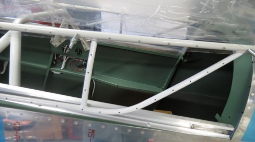

Enlarged holes in canopy frame
I have not yet decided to use screws or rivets so today I decided to enlarge the holes to #36 for tapping to accommodate #6 screws. If I don't like the screws I can always enlarge holes to #30 and use rivets per the plans.
Enlarged to #36
