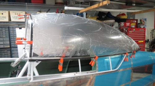

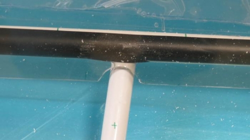

I made another cut along both sides of the canopy. Next, I clamped the canopy to the sides of the frame starting at the aft end. As I moved forward the glass came down and forward a bit so it was necessary to deepen the small arcs in the glass where it contacts the vertical tubes on the frame.
I remarked the locations for the rivets or screws in the aft end of the sliding frame. Starting 3.5" from the splice point (called out in the plans) I marked eight holes in the tubing every 2.3". There is also one hole centered at the extreme aft end of the frame. I also marked the curved bow portion of the frame. You will see in the pictures I taped the frame witth black electrical tape. This allows me to press the glass against the tape and I can see exactly where the point of contact is for drilling the rivet/screw holes.

Clamped on the Frame
Relief Arcs
Relief Arcs

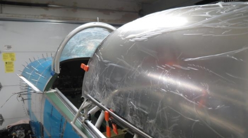

Forward View
Forward View
