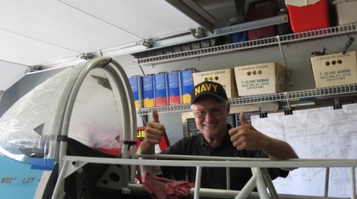

I finally got up the courage to make the big cut to separate the windscreen from the slider portion of the bubble. I had my doubts but in the end I got a pretty clean cut on the plexiglass. I think the windscreen will be relatively easy to fit to the skin and roll bar. A little more trimming will be required in the last 3-4 inches ending at the aft edge of the roll bar. I think the glass will just intersect the skin at the top edge and pull into contact with the bar. If not, the glass will just barely overlap the skin. I won't know exactly how to make this final cut until the slider part of the canopy is completed. I want to get the two pieces of glass meeting as close as possible.

The Big Cut Done
The Big Cut Done
