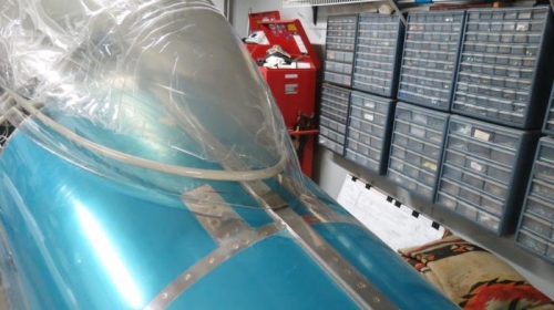

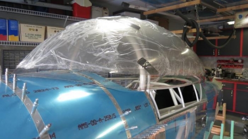

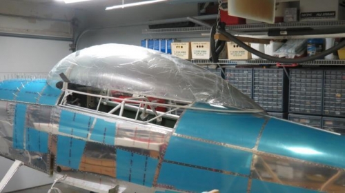

Here is the canopy after 2-3 cuts on the front and one cut on the aft end. I am beginning to get the contour correct where the canopy rests on the forward skin. I still have a number of cuts before the canopy is going to come down close to the canopy frame and the forward canopy bow. My plan is to continue working front and rear before trimming the sides. Geez, I hope this is the correct procedure and it eventually fits!
Front After Two Trims
Back After One Trim
Back After One Trim
End of First Trim Session
