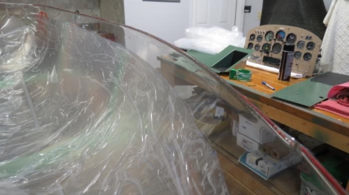

Brief Description:  Trimming canopy protective plastic sheath
I went around the circumference of the canopy and trimmed the plastic protective sheet back about 3-4 inches from the edge on both the inside and outside. I then took 2" packing tape and taped all the way around the circumference so the plastic sheets could not get plexi dust under their edges. I allowed about 1/2" of the packing tape to adhere to the plexiglass, the rest is in contact with the plastic sheet material. Hopefully, I trimmed the protective sheets back far enough.
Plastic Trimmed
Plastic Trimmed
