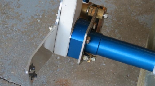

Landing gear shims
I installed a one degree toe out shim on the left and right landing gear axles. This should give me neutral toe in/out.
One Degree Shim
