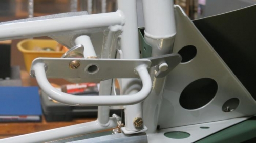

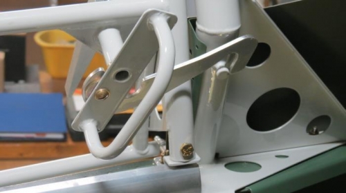

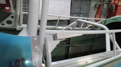

The task this morning was to fabricate the latch for the canopy. The arm you see in the photo must be marked and cut to engage the pin on the canopy bow. I used a Dremel tool with a cutting/burring attachment to slowly cut away the necessary metal. I finished up with a small sanding drum and a scotchbrite wheel. It is shown installed temporarily without the spring.
Latched
Latched
Latch Open
Latch Open
Latch Engaged
Latch Engaged
