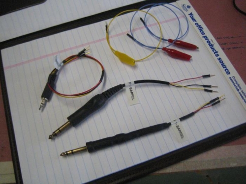

I was careful and double checked the schematics as the wires were connected but still went away wondering if every circuit was properly connected. So, I decided to find a way to check each wire from the jacks to the DB25 connector at the intercom. My solution was to make three test aids from an old set of headset plugs and a 1/8" stereo headphone plug found at RadioShack. You can see the aids below in picture one. I have a wire lead from the ring, tip, and barrel of each plug with a gold pin (Dsub male pin) attached. The three leads are marked tip, barrel, or ring. I also made some short leads with alligator clips on one end and either a pin or socket (again, Dsub pins or sockets).

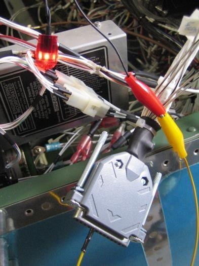

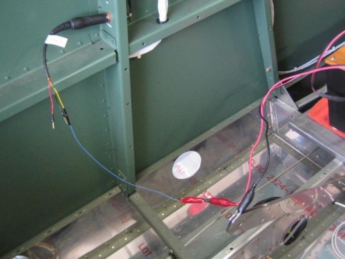

To test, I plug into the jack, select the contact to test (ring, barrel, or tip), and apply a 12V power source (+V to lead and neg to ground). I then go to the Dsub connector and plug into the appropriate socket per the intercom schematic and attach to a LED lamp (other lead grounded). If it lights, I have the correct socket. I went thru this procedure for all the jacks and found one problem on the aux audio which turned out to be a faulty contact in a Molex connector at the 3PDT switch.

Testing Aids
Testing Aids
Power to Jack Contact
Correct Socket?
Correct Socket?
