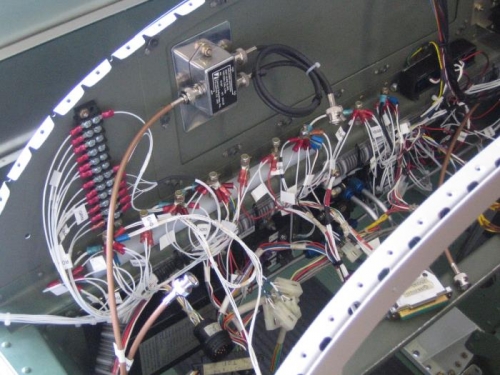

A splitter is required for the coax from the Archer antenna in the port wingtip. The splitter spearates the VOR/localizer signal from the glide slope before it enters the Narco radio. I am running out of room behind the panel so I made a doubler and attached the splitter to the back side of the access panel. I cut the coax to length and terminated with the appropriate BNC connectors.
Coax & Splitter
Coax & Splitter
