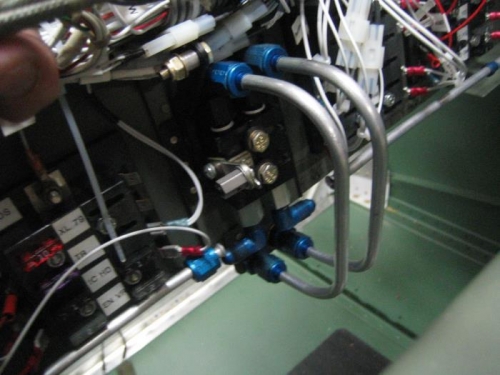

Brief Description:  Reworked lines on parking brake valve
I had to rework the lines on my parking brake valve so they wouldn't interfere with the wiring bundles that are routed under the fuselage cross member. I went ahead and installed the valve and torqued the four connections.
I should mention that it was necessary to install 90 degree elbows in the top of the valve body. I decided to install the elbows, lines, and bulkhead connections with some thread dressing purchased at NAPA auto parts store.
