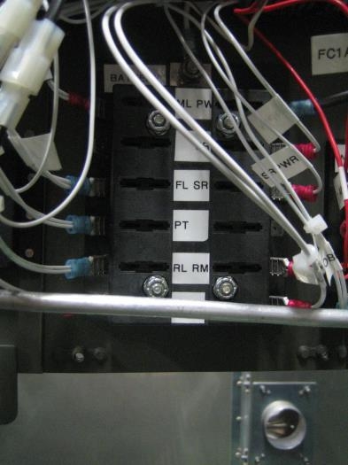

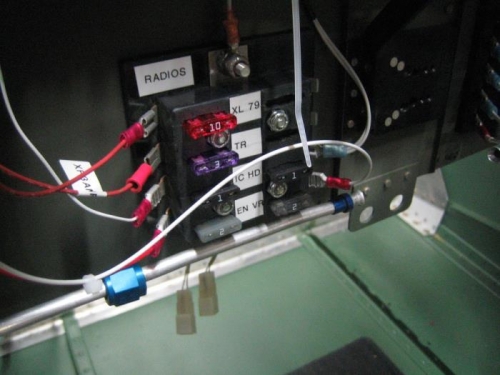

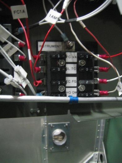

I completed a number of tasks today including attaching all the wires to the appropriate fuse blocks, selecting the appropriate fuses for each circuit, and labeling each of the fuse blocks.
The labels you see on the Radio Fuse Block are as follows: XL-Garmin 250XL, 79-Garmin 796 to be added later, TR-Transponder, IC-Intercom, HD-ANR Headsets, EN-Encoder, and VR-VOR/ILS.
The labels on the Main Battery Buss are as follows: ML-Map lights, PW-12V aux power outlets, BR-Boost pump relay, FL-Flaps, SR-Starter relay, PT-Pitch trim, RL-Roll trim, RM-Right Pmag, IG-Ignition, LM-Left Pmag.
The labels on the Instrument Buss are as follows: FC-Fuel computer, VA-Volts & amps, OL-Oil pressure & temp, EC-Exhaust gas & cylinder head temp, FG-Fuel gauges, HO-Hobbs meter, DM-LED dimmer circuits.
I also modified and rerouted the LED dimmer harness to eliminate some excess wire (the harness was originally sized for the dimmer switch on the left side of the panel). All wire connections for the LED dimmer circuits were completed. To finish up the shop session I did some rebundling of wires to neaten up the overall wire installation.
