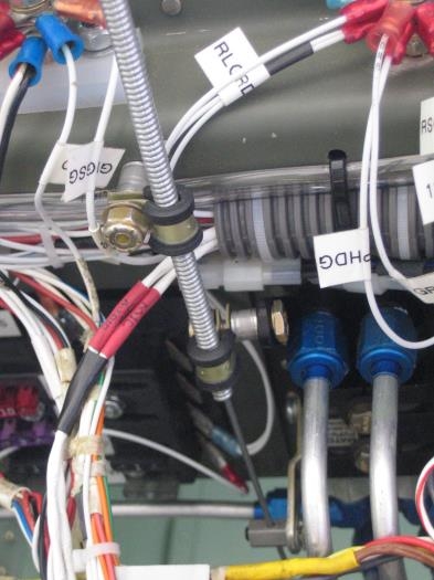

Brief Description:  Parking brake control cable installation
The task list in the shop today began with finalizing how the parking brake cable will be routed and secured to the airframe so the parking valve operation will be positive and reliable. I located the parkingT-handle on the upper right side of the instrument panel. The cable makes a short run up and over to the center of the panel and attaches to the cross-member just behind the baggage compartment. It is routed vertically and is attached with two Adel clamps, one to the cross-member and the second on the mounting bracket for the parking brake valve. I had to make some small bushings for the mounting bolts to ensure the cable is straight and does not bind during full movement of the valve actuator. I will add some pictures later.
