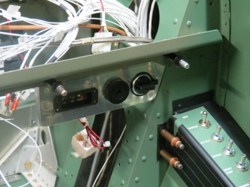

Brief Description:  Fabricated panel mount for ELT and +12V power
I have run out of instrument panel space but still need to install at least three small components. These include a remote ELT switch module, an ELT audible warning buzzer, and an auxiliary +12 volt power outlet for the pilot.
There is simply no good location for these items so I decided to fabricate a small auxiliary panel to be mounted left of the switch/circuit breaker console and just aft of the main instrument panel. The small panel is just large enough for the remote ELT switch, the ELT alarm, and a cigarette type power outlet. I hope it is small enough and mounted where it will not interfere with any extreme stick movements. I won't know for certain until my Infinity grips arrive and the control stick assembly is rigged.
