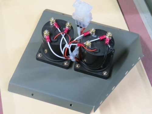

Brief Description:  Fabricated wiring for fuel gauges
I wired the various terminals for the left and right tank fuel gauges and terminated them with a six circuit Molex connector (only five circuits required). The Molex plug will be installed on the fuselage wiring under the fuel panel on the port side of the front cockpit. This will allow a quick disconnect of the panel and gauges for maintenance.
